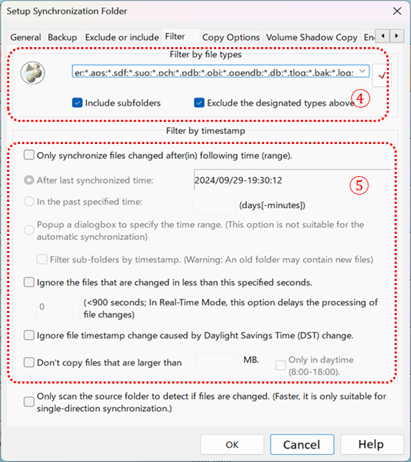

BestSync filters the files and folder in following 5 steps:
BestSync scans the exclude/include list from top to bottom.
For a listed folder, if the checkbox is unchecked, the folder is excluded from the synchronization; if the checkbox is checked, BestSync will also check step 2, 3, 4, 5. If the folder is excluded in any step, the filtering ends.
For a listed file, if the checkbox is unchecked, the file is excluded from the synchronization; if the checkbox is checked, file is included into the synchronization. BestSync will NOT check step 2, 3, 4, but step 5 will still be checked.
When meet "All other files and folders", the scanning ends. But Step 2, 3,4,5 will still be checked.
