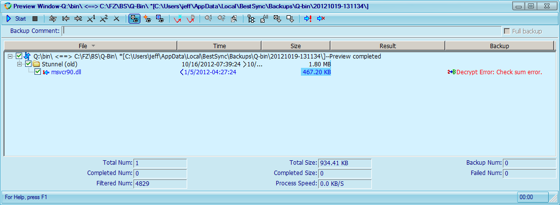

I have one particular file that is not syncing and backing up properly. Specifically, the error in the Backup column of the Preview window says: "Decrypt Error: Check sum error."
Please see the attached snapshot of the BestSync Preview window for more details.
All my other files are syncing and backing up properly, there just seems to be a problem with this file.
I don't know if the file was somehow corrupted. Or, if there is something about that file.
What do you think?
Also, in the Preview window at the bottom, shouldn't the "Failed Num" parameter be 1 instead of 0?
Jeff
Re: Decrypt Error with Backups
The checksum error means the file in "Folder2" was corrupted. May be you need to backup the file again manually by the preview window of the backup task.
