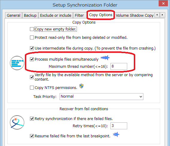

The attached file is the screenshot about setting the number of threads that run simultaneously.
[attachment=0]MultipleThreads.png[/attachment]
You can decrease the number of threads of each tasks to avoid the issue.
