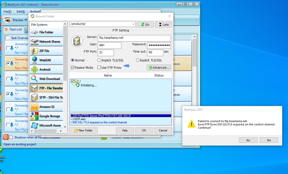

I just upgraded from a very old version (2011) of BestSync to the latest version. One of my FTP connections stopped working after the upgrade. I've attached the message that I am receiving. Files are sent to a server owned by a local IT guy. I don't think that there is any kind of formal certificate for the site. How do I get this issue resolved? Thank you.
Re: 550 SSL/TLS Error
The error from the FTP server says that it need the TLS/SSL to connect to the FTP server.
Please try to select [Implicit TLS/SSL] or [Explicit TLS/SSL] option to see if the error can be resolved.

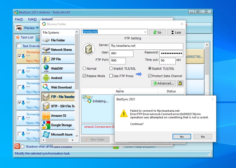

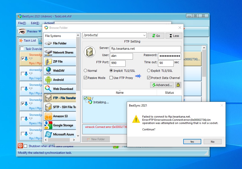

Here is what I get when I try that solution:
Please confirm whether the FTP port is 990 or something else.
