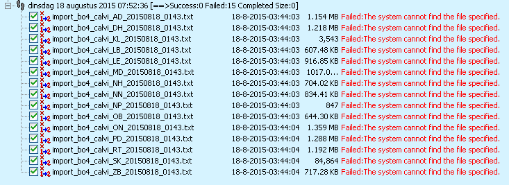

I’m running a task that moves files from a local disk on the BestSync server to a network share on an other windows server. BestSync is running under a service account that also has change rights on the remote share and ntfs.
Everytime the job runs it says it was failed. When I look in the log it says “Failed: The system cannot find the file specified”. But when you look at the destination the files are correcly moved.
What is cousing this behavoir and how can I solve it. We are using the latest version 10.0.3.6.
[attachment=2]Taak.png[/attachment]
[attachment=1]Log.png[/attachment]

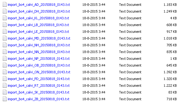

The destination folder.
[attachment=0]Destination.png[/attachment]
