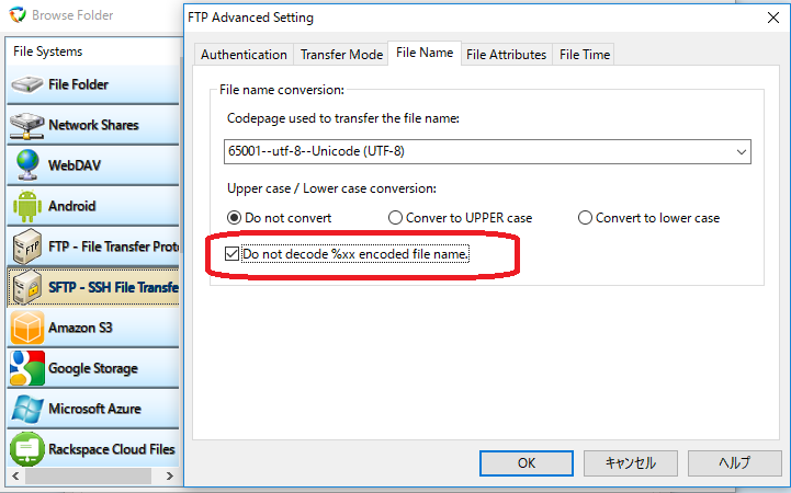

You can try the "Do not decode %xx encoded file name" option to avoid the problem.
Please see the attached screenshot picture.
[attachment=0]FTP_ADV.png[/attachment]
FTP advanced setting
