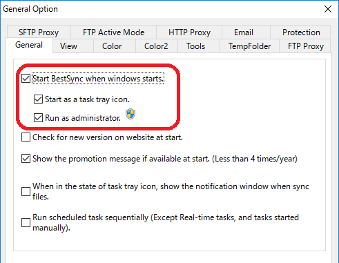

This may be the privilege problem. Windows has prohibited BestSync from saving the task profile.
Please try to start BestSync by Administrator privilege once, and try to check the options as the attached screenshot by "Options/Options" menu.[attachment=0]StratOption.png[/attachment]

Risefly,
That is what it has been set in the beginning when I installed BestSync.
OS: Windows 10
Re: All task missing after reboot
May be BestSync has no right to write the task setting to the current setting folder,
please try to use "File"/"Save as" menu to save the task profile to a different folder.
