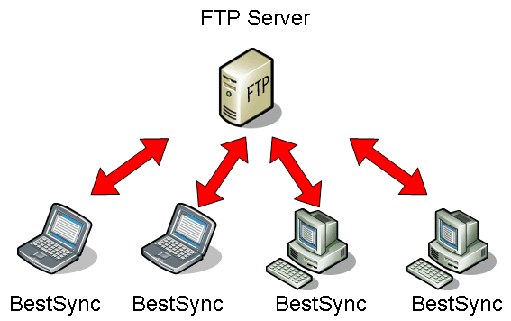

Re: Questions regarding business version
How about setup the tasks like the attached graph?
- Sync Multiple PCs
- sync_pcs.png (37.39 KiB) Viewed 18229 times
The ftp server option would work well, but would the Ultimate version be faster for syncing? "Fast Scan!
Scan multiple sub-folders simultaneously.Fast Copy!Copy multiple files simultaneously." I know I am limited by connection but running faster on the pc is more what I am concerned about as scanning a 6 Gb folder can take a while if it is set for 2-way syncing every time.
Additionally, if it is, how many licenses would be needed as it is a little confusing on the description of licensing. "The activation count of license is equal to the license number PLUS TWO. i.e., ONE license can be used on THREE computers; TWO licenses can be used on FOUR computers."
For 6 pc's would I need 4 licenses or 6?
If your FTP account allows multiple sessions, then I recommend to to use the Ultimate License and use "Process multiple files simultaneously" option and specify the thread number that your FTP server allows. This will improve the performance upto many times of one thread.
For the license number, if you are a personal user, you need 4 license for 6 PCs; if you are NOT personal user, you need 6 licenses for 6 PCs.
