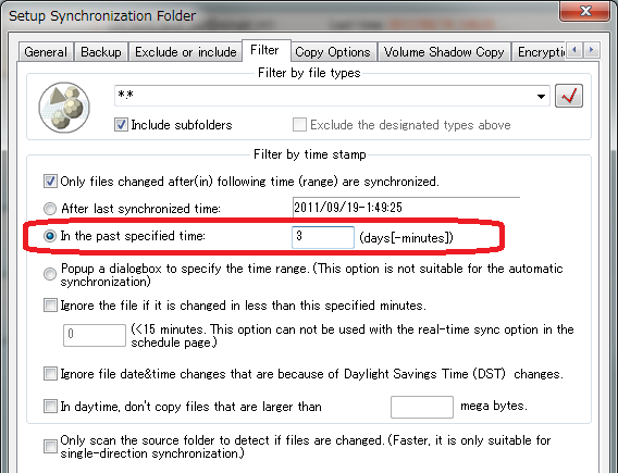

And, does the following filtering option meet your demands?
- Filter files by day-range
- Filter-Days.png (50.35 KiB) Viewed 15001 times
