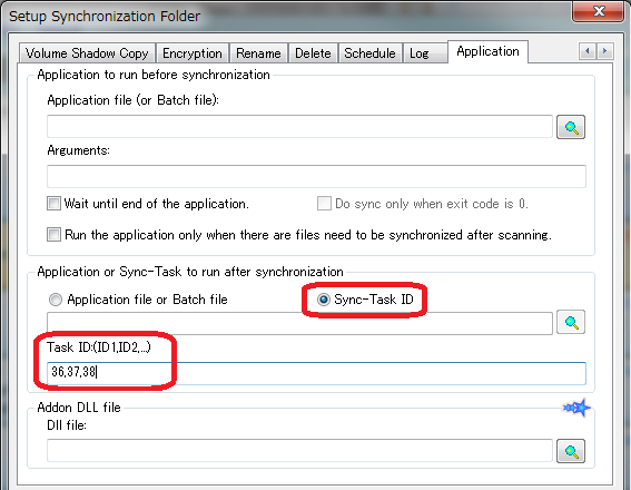

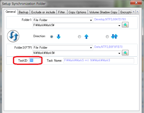

Re: Automatically start next task without schedule
You can use the "Application" setting to run multiple tasks after the task is synchronized.
Please refer to the attached grphics.
Start Next Task After Sync
Task ID
Task ID
macrodev
Joined: Tue Nov 08, 2011 4:16 am
Post by macrodev »
OUTSTANDING! You guys are the BEST!
