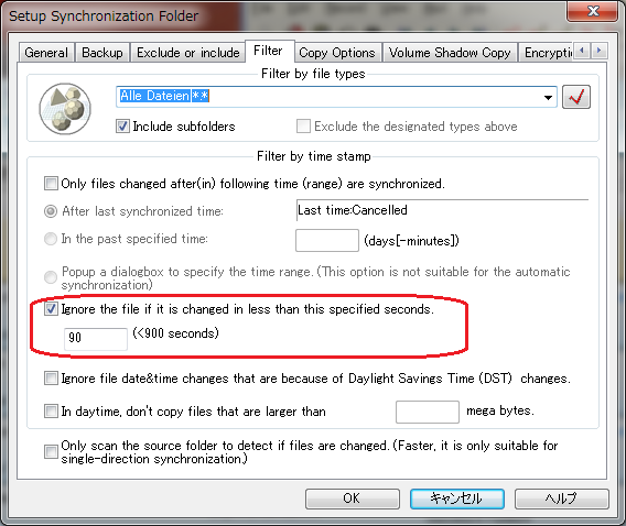

We have just release BestSync 2012 (Ver7.0.22), the new version has enabled the "Ignore the file if tis is changed in less than this sepcified seconds" [XXX] (<900 seconds) option in the "Filter" setting page, even when the real-time synchronization options is selected. Please try the new version.
- Ignore Recent Change
- IgnoreShortChange.png (63.53 KiB) Viewed 43282 times

Thanks but this doesn't solve my problem. Tried it and it seems to brake the real-time synchronisation totally for the way 3DsMax saves.
By the description of the feature it sounds like the opposite of what I need. What I need is a delay before back, not a delay after. With a delay before, the file can finish saving before syncing so it syncs the completed saved version. With a delay after, it only syncs the 1/2 saved and as such, corrupted version, then after its synced that, the file gets 100% saved but then with this file being changed within the time, wont sync the latest file as its in before the time limit.

In Real-time sync mode , "Ignore the files if it is changed in less than this specified seconds" option gives the application (3dsMak) time to save the file, BestSync will sync the file after the waiting time.
