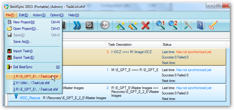

I have just unzipped all but the language dlls to H:\Utils\BestSync8 of BestSync 2013 (Portable) English Version Ver8.0.5.9(64Bit).
under Windows 7 Ultimate + SP1
I have added one task and the information is held in
H:\Utils\BestSync8\ALAN-DESKTOP\TaskList.xfsf
The attached screenshot shows this as
2 H:\Utils\...\TaskList.xfsf
The screenshot also shows corruption by previous history of earlier versions of BestSync in two different folders in partition R:\
If I use "Edit" I can Delete the task that compares I:\OCZ with M:\Image\OCZ,
but what I wish to do is remove ALL reference to the pair of files shown as
R:\E_GPT_E\...\TaskList.xfsf
I have already changed the filenames on drive R:\ to
#TaskList.xfsf.txt
but BestSync still shows these files by the original names and still BestSync shows them as R:\E_GPT_E\...\TaskList.xfsf
and it still sees the three comparison tasks that were established in the past.
Perhaps before renaming them I should have disabled the Windows Service
"Distributed Link Tracking Client"
I am prepared to unzipp and try again.
Please tell me how to ensure that past history and settings in other partitions will NOT intrude again
Alan
Re: Portable BestSync 2013 is corrupted by Registry/History
Version 8.0.6.0 has fixed this problem, Please try the new version.
If you want to remove the file from the list, just deleted the project file.

Many thanks.
Problem fully resolved.
