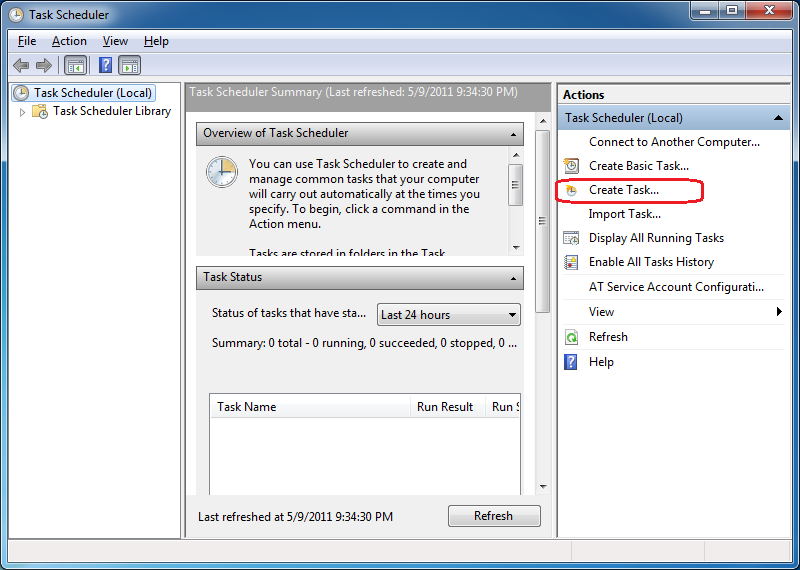

- Open theTask Schedulerby going to theStart Menu,All Programs,Accessories,System Tools,
and openTask Scheduler.
- ClickCreate Taskon the top right of the Task Scheduler window.

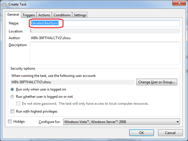

- Give the task a name in theNamebox in
the Create Task window.
Remember this name ( Elevated BestSync ).You will need it later.

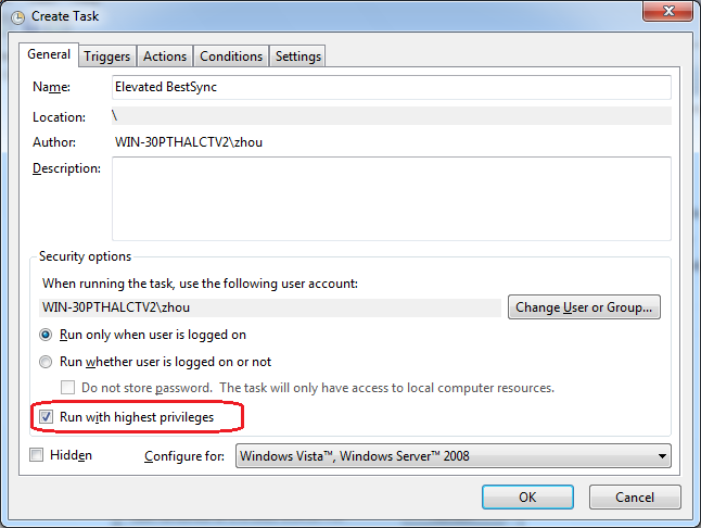

- Check theRun with highest privileges box.

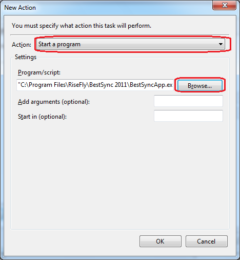

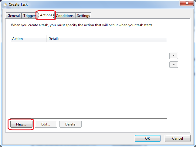

- ClickNewin theActions tabof the Create Task window.
- Browse to the location of the BestSync Application
("C:\Program Files\RiseFly\BestSync 2015\BestSyncApp.exe")
in theProgram/scriptbox and then clickOK.
- ClickOKto close theNew Actiondialog box.

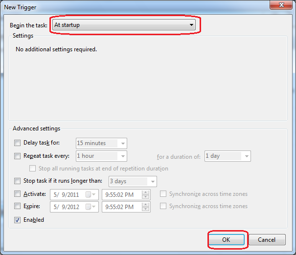

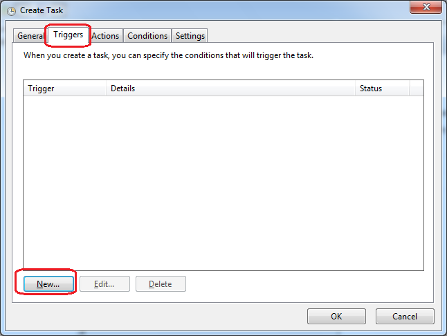

- ClickNewin theTriggers tabof the Create Task window.
- SelectAt startupin theBegin the taskcombo box, and then clickOK.
This will start the BestSync Application when Windows starts.

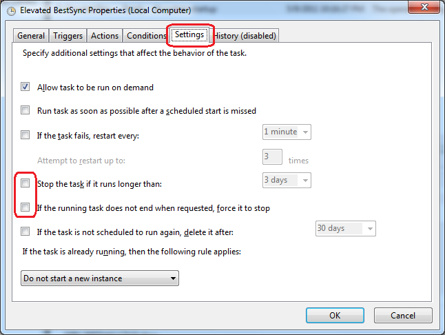

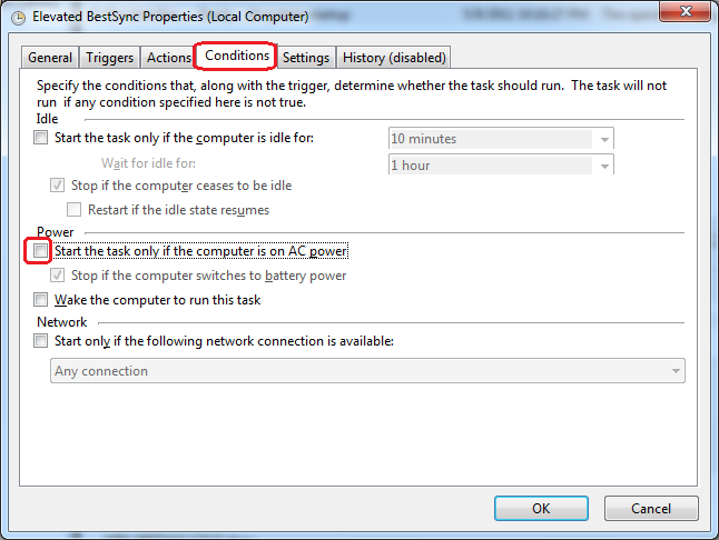

- Please uncheck the following settings that may affect
auto-start, then clickOKto close theNew
Actiondialog box.

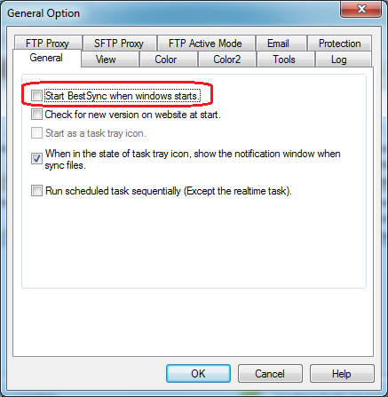

- Don't forget to uncheck the auto-run option in the
BestSync application itself.
