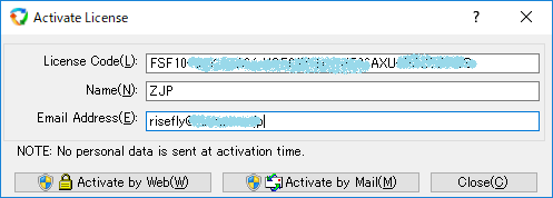

If your PC is not connected to the internet, you can press the "Activate by Mail:" button to activate your license manually.

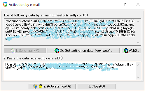

The "Activation by e-mail" dialog box is displayed.

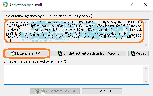

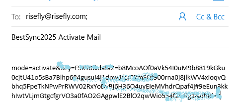

If the PC has a mail application such as Outlook installed, you can press the "Send mail" button to start the mail application and the sending data is set to the mailer automatically. If the PC can not sent the mail directly, please copy the data to clipboard, and paste it to an edit application such as notepad.exe, and send the data by other PC by mail to risefly@risefly.com .

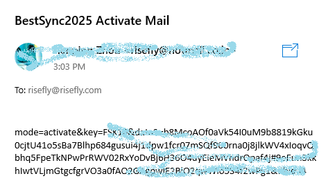

(Send the activation data by email application)RiseFly software will send the activated data to you by mail (in days).
(The activation data received by email application)Copy and paste the received data to the "Activation by e-mail" dialog box like following screenshot.
And press the "Activate Now" button to activate the license on the local machine.
When you see following dialog box, the activation is completed.
