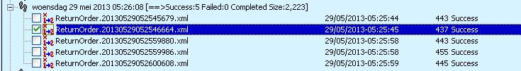

We're use Bestsync 8.0.5.5 to sync files between our file server and ftp server (in DMZ).
Yesterday we received a complaint because a file wasn't send from the fileserver to the FTP server.
The logging of BestSync states that the file was transfered succesfully (see attached image).
[attachment=1]BestSyncLog.JPG[/attachment]

Re: BestSync Result Succes, but file not on FTP
I seems that it failed when "Rename from intermediate file". Please confirm if the account has the full privilege to rename the file.
Could you please start the Preview of the task, then save the log data on the bottom of the windows to a file, then post the log file here?
