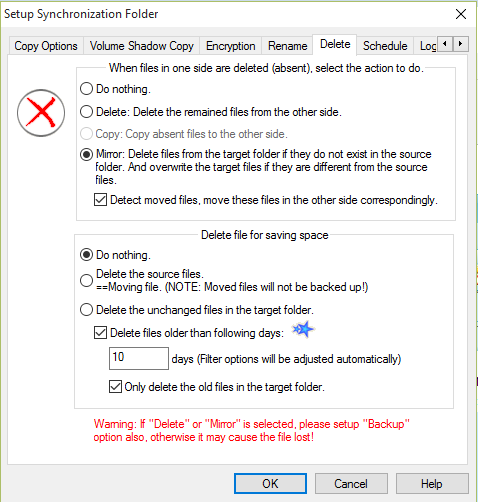

I will use BestSync to sync a local folder to google drive. I use 15gb free account on google drive and i have to delete old files like 20 days old on google drive side.
I am trying BestSync on my local folders for now and i have following settings to delete target folder side but it doesn't work.
how can i do it?
Thank you.
[attachment=0]bestsync.png[/attachment]

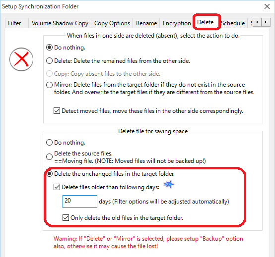

You can try the following option to delete files that are older than 20 days in the target folder (Google Drive).
[attachment=0]DeleteOld.png[/attachment]
Delete Old Files
Delete Old Files
