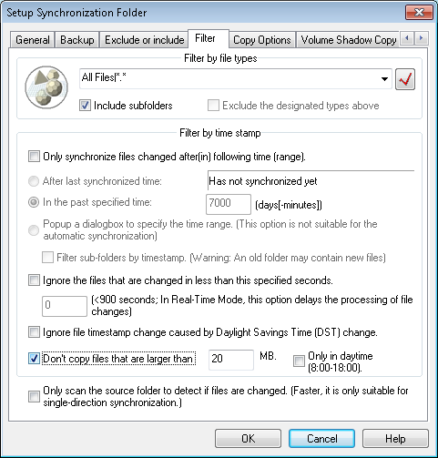

When I use a Filter - Don't copy files that are larger than (e.g.) 20MB
(see attached snapshot).
and then Preview Task.
The files that are larger than 20MB are also shown (selected).
Why is that?
Filter Tab - don't copy large files is checked
Filter - Don't copy files that are larger than 20MB.png (24.49 KiB) Viewed 32863 times

Though large files are still listed in the preview, but they will be ignored from the synchronization.
If you download and install the newest version, when you run the synchronization in the preview, the result will be "Ignored by file size filtering".

Great, thanx! 8-)
