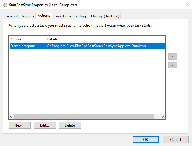

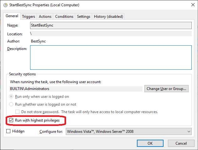

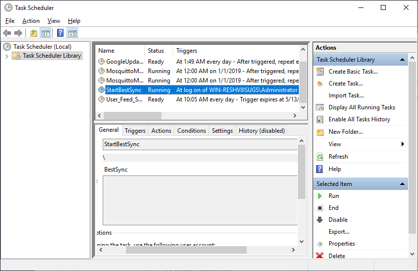

Please confirm in the Windows "Task Scheduler" to see if the " StartBestSync" Task is set correctly as the following screenshots.
"Task Scheduler" is in the Administrative Tools of Control Panel.
StartBestSync Setting1
StartBestSync Setting2
StartBestSync Setting3

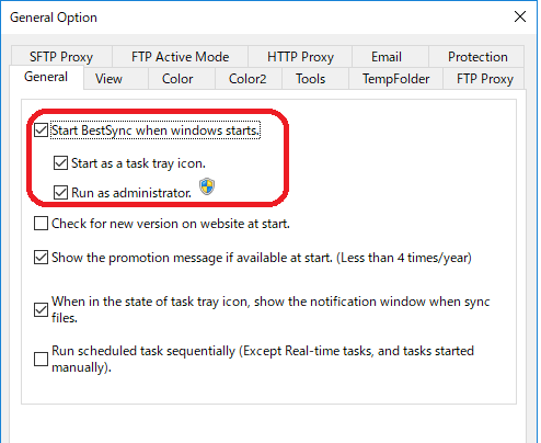

The problem may be caused by Windows update and antivirus software. Please try following steps to see if the problem can be resolved.
(1)Exit BestSync Application.
(2)Stop antivirus software.
(3)Start BestSync Application by "Run as administrator" context menu of the BestSync desktop icon.
(4)Open the option menu, uncheck the auto-start settings, close the dialogbox.
(5)Open the option menu again, check the auto-start settings like the following, close the dialogbox.
