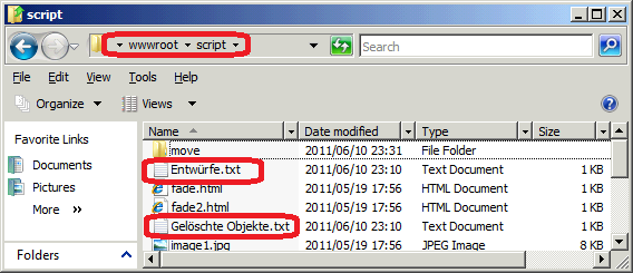

Re: BestSync seems to have problems with Umlauts
We have tested synchronizing file names with Umlauts with Windows IIS server, the result is OK.
Please check if your server support UTF-8.

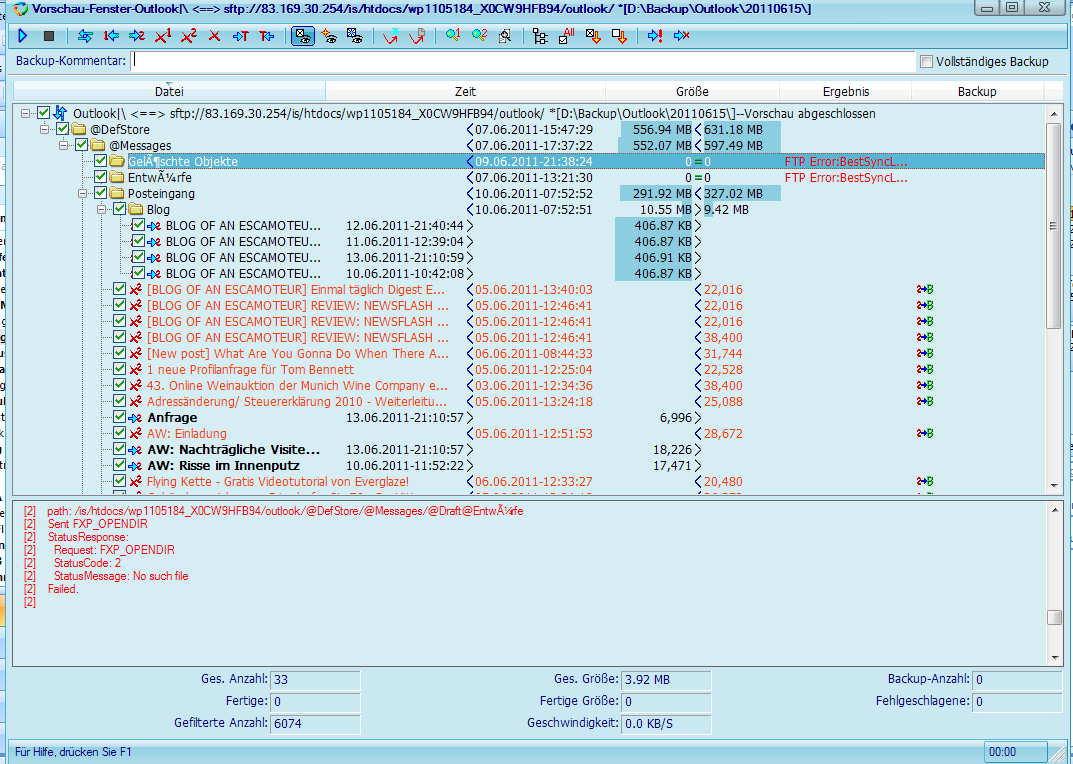

Perhaps, this ovservation might help you further.
When looking at the preview it looks like, that the Problem with the Umlauts occurs already when acessing Outlook.

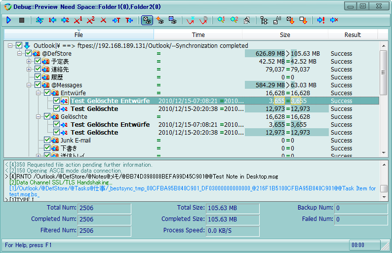

We have just released the new ver 6.0.15, please try the new version.
We have tested synchronizing Outlook with SFTP folder, the result is also OK. Please refer to the graphics.
Synchronizing Outlook with SFTP folder with Umlauts characters
Post by escamoteur »
Now this is really strange. Every now and then I do a preview the Umlauts are ok, other times they again are displayed wrong like above.
If you want to send me a debug version that outputs a log, I'm happy to help you.
