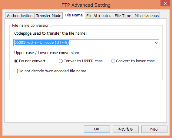

The cause of this problem is BestSync can not convert the FTP name from the server to Unicode Windows file name.
Please try to set the UTF-8 codepage (or other codepage that works for the server) in the "advanced setting" of the folder browser of the FTP server.
[attachment=0]codepage.png[/attachment]
FTP code page
FTP code page

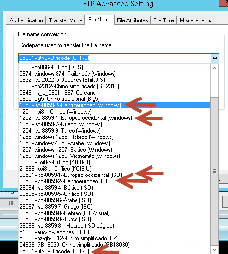

I tested different codepage using preview task but the error has not solved.
Thanks for your help.
codepage
codepage
Re: Duplicate file names
After select the codepage, please try to synchronize the task once. Or delete the unneeded files manually.
Because old files that have been created by wrong codepage already exist.
