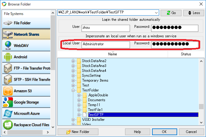

Thank you for the exported task setting.
I have found a problem in the setting, you must setup the local PC account in the folder browser of the network shared folder, if the task need to be ran as Windows Service.
See the attached the screenshot:
[attachment=0]SyncNetSvc.png[/attachment]
Sync NAS folder as Service
tjblow
Posts: 70
Joined: Fri Mar 28, 2014 5:31 pm
Re: Has not synchronized yet
Post by tjblow »
I added the local user and it still has a status of has not synchronized yet? Sent a new email with the exported task file attached.
