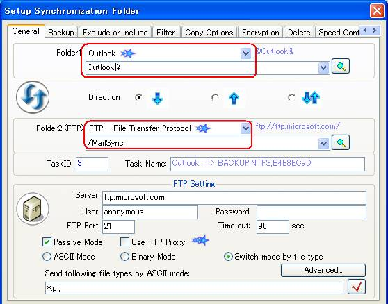

I recommend you to use the Outlook-Sync feature, this feature only transfer new emails and contacts etc to FTP server. And Premium License of BestSync 2012 is enough for this usage.

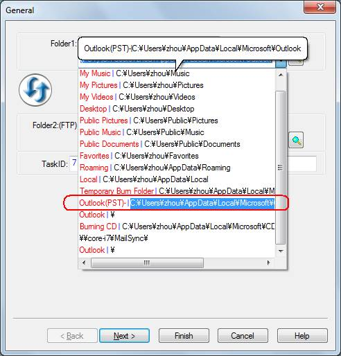

BestSync can also synchronize .PST files to FTP server, just select the folder that contains PST file like the following graph:

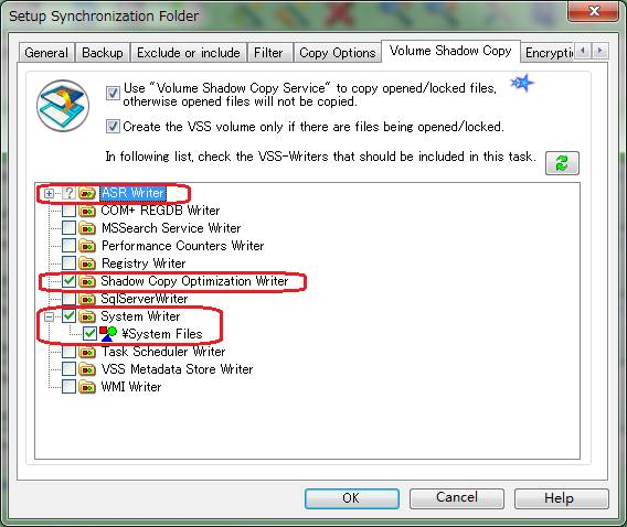

And need to select “Volume Shadow Copy”option like the following:
[attachment=0]VSS_PST.png[/attachment]
Please note, to use VSS option, you need to start BestSyncApp.exe as Adiministrator privilege, like the following:
