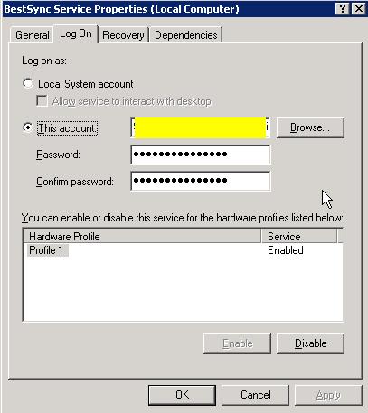

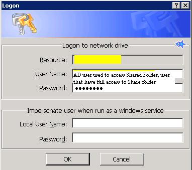

I'm sending you two ScreenShots of my current config.
First is about how all the tasks are configured and the second is for Service config.
Still no luck figuring why all the task freezes with Synchronizing status...
Thank you
Thank you
- Task Config
- screenshot.jpg (24.38 KiB) Viewed 55368 times
- Service config
- screenshot2.jpg (30.53 KiB) Viewed 55368 times

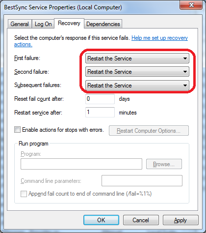

Have tried the following setting to restart the service when error happens:
[attachment=0]RestartService.png[/attachment]
- Restart Service
- RestartService.png (45.49 KiB) Viewed 55341 times
