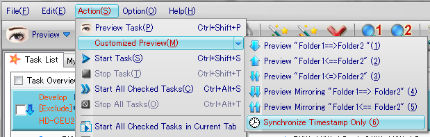

I have already uploaded many files into Amazon S3 by "S3 management Console", at first time after setup the task, BestSync try to download these files, how to avoid this action.

Because Amazon S3 has not a feaure to preserve the timestamp of the uploaded file, Bestsync uses a custom meta data called "x-amz-meta-lastmodified" to preserve the last modified time stamp. And custom meta data can not be modified after the file is uploaded.
If the file is not uploaded by BestSync, then the file has not "x-amz-meta-lastmodified" meta data, the “Last modified” filed of original amazon S3 is just the time when the file is uploaded, so BestSync thinks it is a new file and will download it to the local folder.
To avoid the problem, and you are sure that the file in Amazon S3 is updated, you can use the following menu to synchronize the time stamp only:
[attachment=1]SynchronizeTimestamp.png[/attachment]

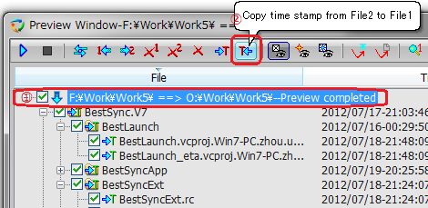

Please note because the "x-amz-meta-lastmodified" can not be modified after file is uploaded, you must use “” to copy the timestamp from Amazon S3 to the local folder.
[attachment=0]ChangeTime.png[/attachment]
