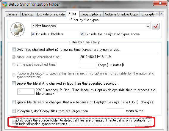

Please confirm that you have not check the following option:
[attachment=0]ScanSourceOnly.png[/attachment]
If the option is checked, BestSync will not scan the target folder and only uses the last saved record.
When you exchange the drive, this option may cause the issue that you meet.
- Scan Source Only
- ScanSourceOnly.png (51.38 KiB) Viewed 10701 times
