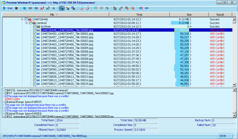

I know this is probably an easy fix, but I couldn't find a resolution anywhere else... I have three servers, all with BestSync 7.3.1.7 32 bit, all synchronizing back to a single WebDav location. The file structure at each site is nearly identical, but each site also has files that are unique from the other two sites. Each site is unique - there is no file duplication between the three sites. I need to consolidate the data from those three sites into the single WebDav site.
My problem is that I am seeing 409 conflicts (The page was not displayed because there was a conflict) when the other sites attempt to merge their contents into a directory that one of the other servers has already created.

I have attached a screenshot of the error as it appears.

409 error is returned from the webdav server, may be because that the parent folder does not exist when upload the file, or the property of the file is read-only.
BestSync should create the folders before upload the file, but may be failed, please check if the account has the privilege to MKCOL (create collection), and if the server let the client modify property (PROPPATCH).
If you can export the task setting to a file then send to risefly(a)risefly.com, we would like to debug this issue.
