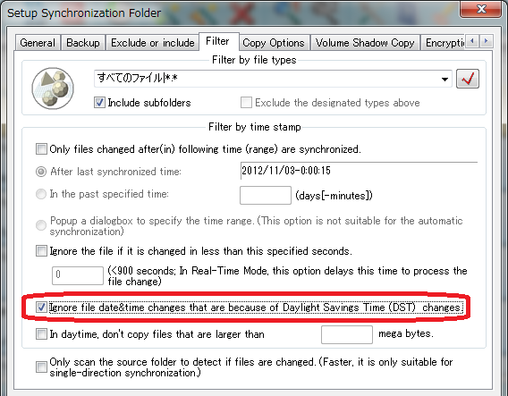

Re: Ignore 1 hour difference - how
BestSync has an option called "Ignore file date&time changes that are because of Daylight Savings Time(DST) changes".
Like the attached bitmap. Please try the option.
[attachment=0]DstTime.png[/attachment]
Ignore Daylight Savings Time
