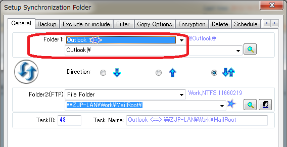

Please do not synchronize the folder that Outlook uses to save PST files directly, instead select "Outlook" in Folder1. This way uses MAPI, only synchronize new emails and contacts, even Outlook is running, it still can synchronize with it.
[attachment=0]Wz_Outlook.png[/attachment]
