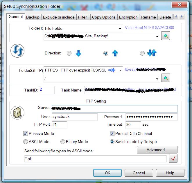

From the new log, it seems that you have selected FTPS instead of FTPES.
Please confirm if you have selected "FTPES - FTP over explicit TLS/SSL" in the "General" setting page of the task.
Re: FTPES connection error
It is definitely not set for FTPS. I have attached a screen shot of the setup screen.

- task setup.jpg (77.63 KiB) Viewed 25077 times
