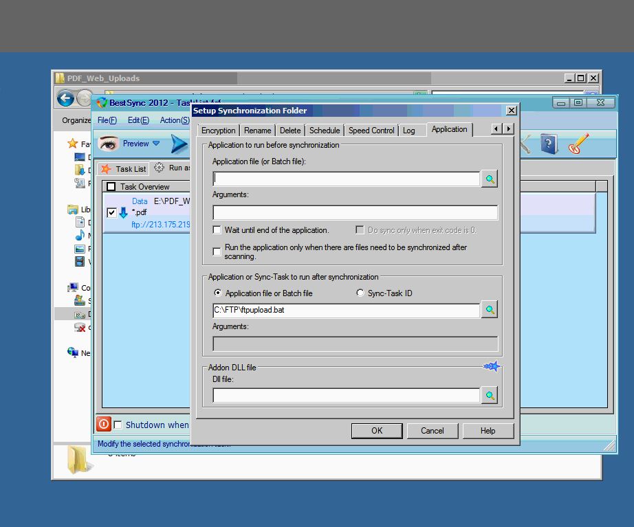

Your software uploads okay but I need to run a batch file to move local files once they have been uploaded but this isn't working. The batch file works fine if I run it manually but isn't running after sync.
This is how I have it set (attached)

BestSync should be able to run the batch file after the synchronization.
Please click menu "Option"/"View Log File" to see if BestSync failed to run the batch file.

The log doesn't even show it trying to run the batch file.
