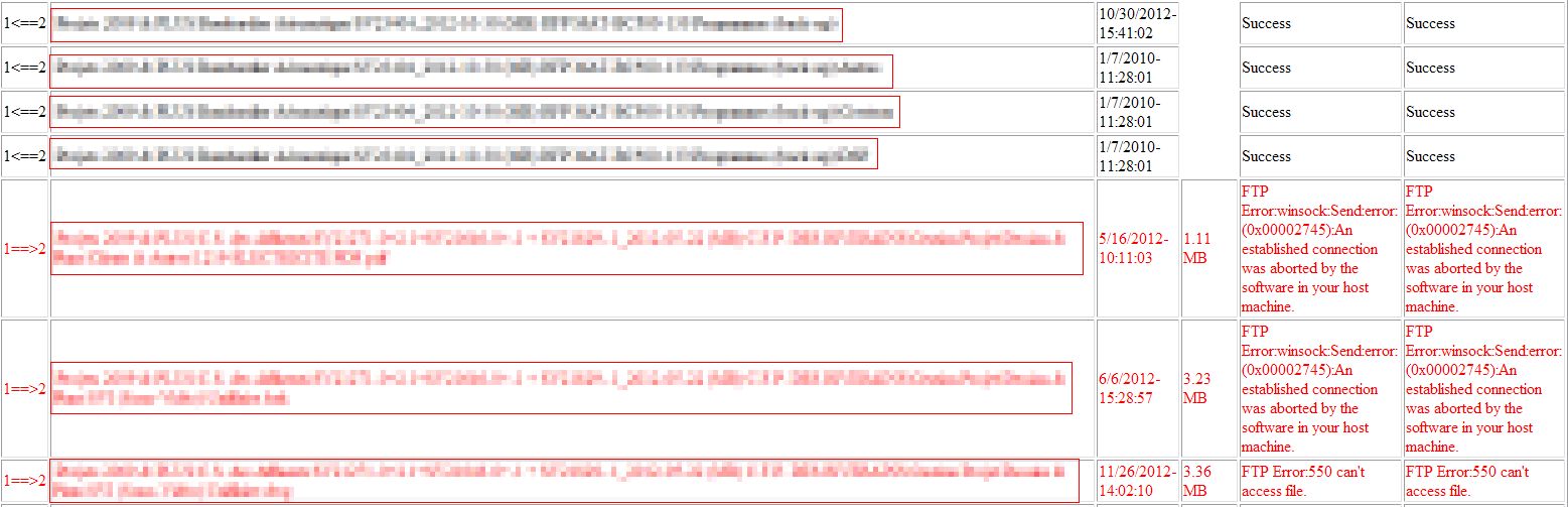

I see in the log file that we have some “success” with the synchronization in both side. I just want to confirm if it is a firewall issue
Best regards,
Best regards,

Yes, I'm sure that the problem is caused by the firewall setting.
