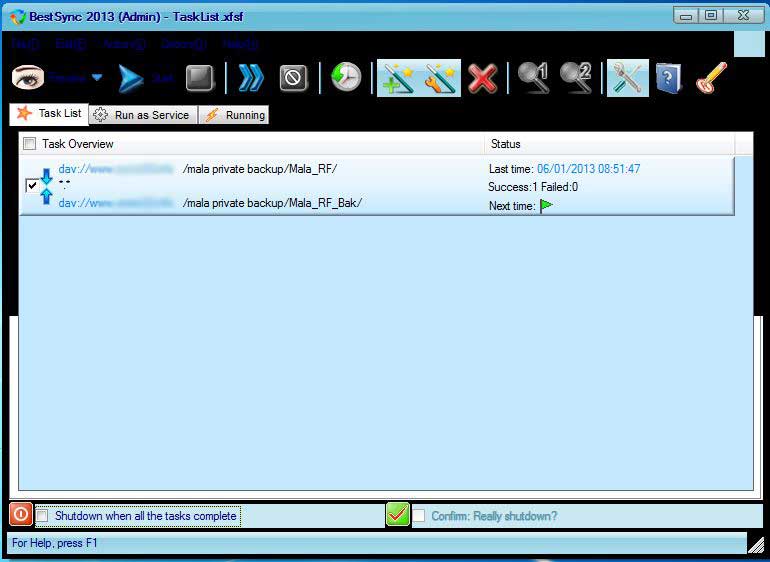

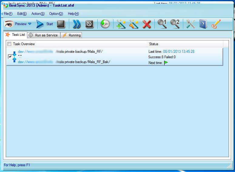

Getting an incomplete GUI, this is the only application with black parts in the GUI
v8.0.1.3 64 bit,

For the black GUI, we have never seen this symptom. If you size the window, does this symptom disappear?
Re: WebDAV - connection error - Initial testing
The full screen looks Okay (64bit), when smaller it reverted to this with some buttons missing, I have checked all other applications on my system, this is the only one that is playing up.
