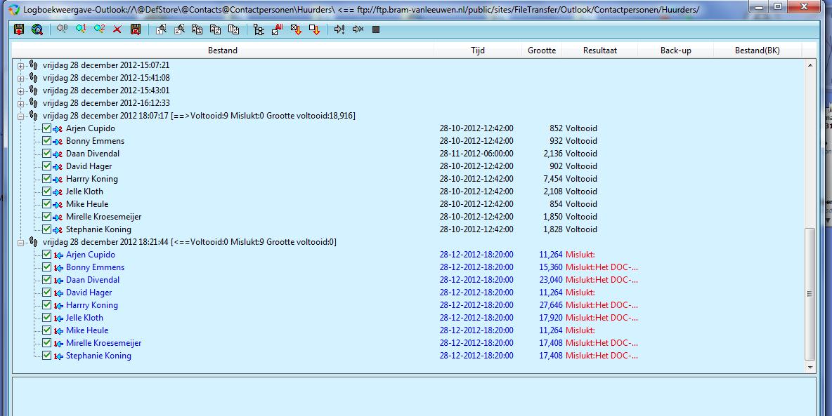

I updated my BestSync program from 2012 to the new version 2012. I experienced problems in synchronizing my desktop (window 7 32 bit) with my laptop (Windows 7 64 bit). File sync is all right, but Outlook synchronization fails.
The window below contains the error messages of the 64 bit computer (64 bit Outlook+ 64 bit BestSync. )
At 18:07:17 I exported a directory (contacts) to an ftp site. Everything OK. See the log in the attchment.
I deleted the directory on the ftp site and exported the contacts from an identical directory of the 32 bit desktop to the ftp-site and tried to import it on the laptop (at 18:21:44): See error messages in the attachmant: (Translation: Mislukt=failed Het DOC-= The doc-file is damaged.)
It is strange that the files send backward are far bigger than the files send from the laptop. They should be identical, I expect.
When I send Outlook-massages in the outher direction: exacly the same problem. Above is a example of contacts that are syncronized, but with messages I experience the same problems.

- Logging the tasks
- Log.jpg (114.53 KiB) Viewed 18834 times

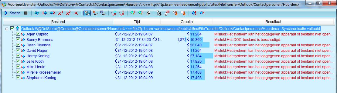

Re: BestSync 2013: Problems with syncronizing Outlook items
No, not yet.
I renewed the program on both sides.
The same problem:
"Failed: The system cannot open the device or file
"[attachment=0]Error.JPG[/attachment]
Regards, Bram

- Error.JPG (107.4 KiB) Viewed 18838 times

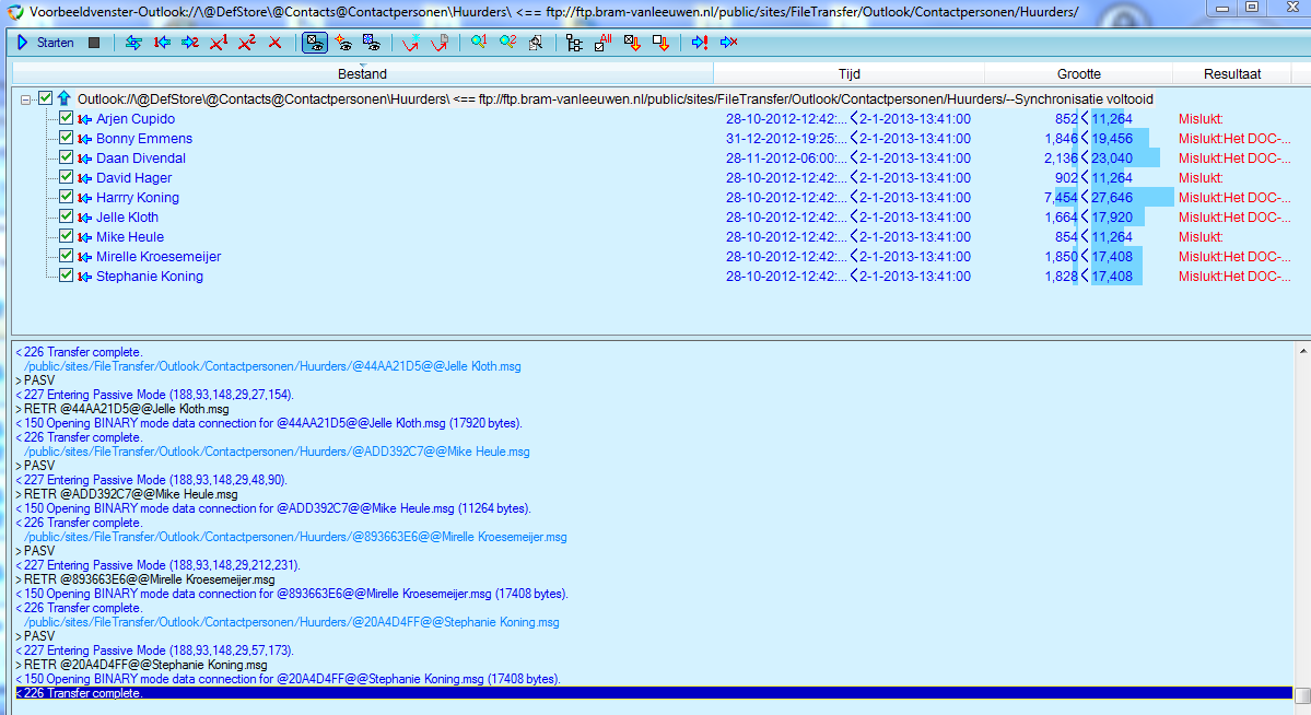

no my temp directory has enough space, space there is not restricted. I added a more complete logging of the ftp import. The log indiacates (see attachment) in my opinion a correct transport from the ftp site to the computer.
Is it OK that the files are imported in binary mode? (see the listing). In the ftp-settings (of the BestSync task) the ASCII mode is selected.

- Ftp connection.PNG (142.01 KiB) Viewed 18821 times
Please try the "Binary Mode" to see if the problem can be resolved.
no I tried it already. I suspected the ftp transport and I tried different possibilities.
But In the meantime I discovered that my conclusion that the problem arises on importation is wrong.
I have another laptop with BestSync 2012. When I export a contact from the computer to the ftp-site importation on the computers with BestSync 2013 is without problems. The problem relies also on the files that are exported by the computers with BestSync 2013, although the error message is generated upon importation (not so strange).
In the attachment you see 3 files after transportation by AceFtp to a computer.
The file Test van testum (a silly testname) is generated by the BestSync 2012 laptop. That file is imported without problems. I changed one letter (test -> Test) and maybe a second letter and exported the contact again to the ftp site.
The exported file (with the uppercase T) will not import.
It is strange that both files (with the 'same' contact) show different icons (contact and 'envelope' icon) after transport) although both extensions are .msg. I cannot explain.
I send you 3 files by email. Only the file with the lowercase is imported. Both other files are refused.
Best regards,
Bram

- Files from the ftp site.JPG (19.83 KiB) Viewed 18805 times
thanks: problem is solved! The solution lies in the binairy ftp-transfer. I succesfully synchronized some contacts.
