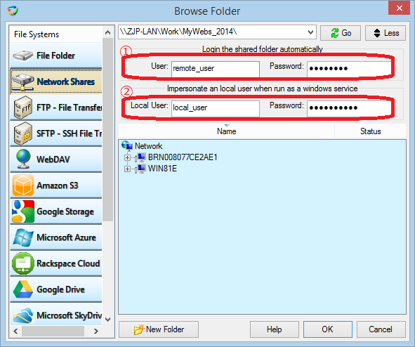

The symptom means that BestSync can not log into the network drive/folder by the account that you specified in the "Browser Folder" dialogbox.
Please check if you have specified the correct user name and password like the following screenshot.
[attachment=0]NasLogon.png[/attachment]
