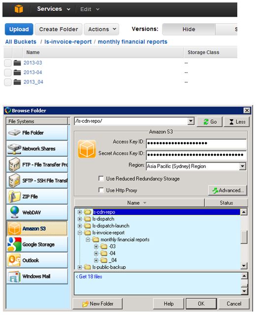

2. As far as I am aware Amazon supports "-" and "_" in its Bucket, Folder and File Names. I can't find any other literature to the contrary. As you can see from the screen shot attached, I have tried both options in S3 and it lets me create them without issue. It is only when I am browsing the folders in Best Sync that it appears to truncate the folder names before the "-" character. I have used other S3 copying tools and they have never had an issue with the "-" character. I am hoping you can address this one in Best Sync.
- best_sync.jpg (67.92 KiB) Viewed 21408 times

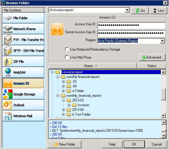

Our S3 bucket did not have any uppercase characters in it, so that was not the issue. However I think I have discovered what the bug is with BestSync. It appears that BestSync cannot properly list/display sub folders in S3 if the parent folder has spaces in it. I have attached a screen shot of the BestSync Browse Dialogue that shows a comparison. I created a duplicate of our parent folder 'monthly financial reports' in the same bucket but this time replaced the spaces with under scores. You can see that underneath the folder with the under scores the full folder names are visible and you can even expand those to see their sub folders. However on the folder that uses spaces, all of its children folders have a number of characters truncated and it wont allow you to expand them to see whats in there. Could this issue be addressed? From what I have read, AWS fully supports spaces, full stops, hyphens and under scores as well as a combination of upper case and lower case characters.

- best_sync_2.jpg (72.82 KiB) Viewed 21400 times
Re: Amazon S3 Connection Issues?
BestSync version 8.0.5.7 has fixed a bug related to this problem.
Please download and try the new version to see if the problem has been resolved.
