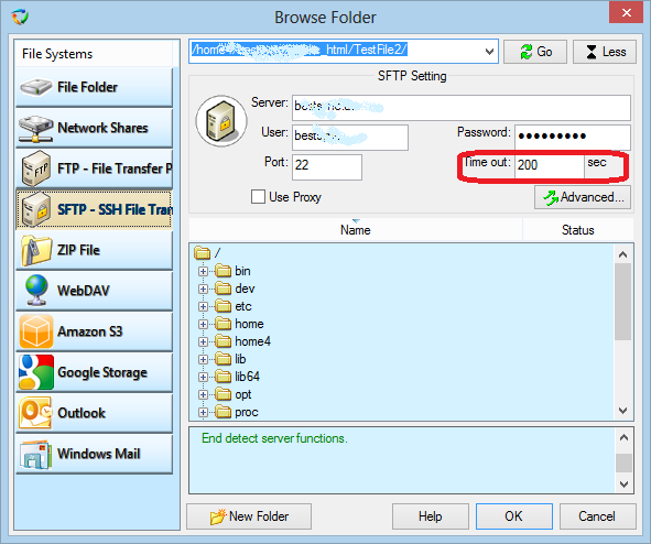

Re: SFTP doesnt complete one way sync
Here is the folder browser of SFTP where you can set the timeout time.
[attachment=0]SFTP.png[/attachment]
thank you for this,
I changed it from 180s to 600s and problem is still occuring. I noticed when watching preview windows, that as soon as download wants to process the file is fails right away. It doesn't seems to wait for x amount of time.
