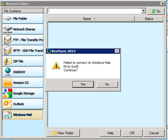

I have upgraded to BestSync 2013 32-bit edition after discovering that BestSync 2012 64-bit edition is not compatible with Windows Mail; I was getting 'could not connect to MAPI' errors and apparently BestSync and Windows mail have to be the same bit edition (the latest version of Windows Mail is 32-bit).
However, now when I select Windows Mail when creating a new task, I get the error below, even though Windows Mail is installed. I'm running Windows Server 2008R2
[attachment=0]Screen Shot 2013-06-18 at 3.06.34 PM.png[/attachment]
Screen Shot 2013-06-18 at 3.06.34 PM.png (50.39 KiB) Viewed 23133 times

After you installed Windows Mail, have you setup a mail account, and tested sending and receiving email?

Yes, I can send and receive fine from Windows Mail. I have rolled back to BestSync 2012 (32-bit) and the Windows Mail folder is set as: Windows Mail|\
I get the error 'Failed to connect to the MAPI'
Any ideas?

I have tested synchronizing with Windows Mail in Windows VISTA. The first time when I browsed the Windows Mail Folder, the same error dialog box popped up. I ignored the error, and press the continue button.
Then I exit BestSync, and run it again by Administrator, BestSync synchronized Windows Mail without problem.
Later, even I start BestSync in normal privilege, it can still synchronize Windows Mail correctly.
Please try the above steps to see if the problem can be resolved.

Hello, I have tried the steps you provided (Running BestSync as an Administrator) and still get the same error. Here is output from the log file:
APP:2013/06/27-09:05:49,Init Windows Mail API Failed. Error=80040154
APP:2013/06/27-09:05:49,Failed to initilize Windows Mail API.-Windows Mail|\Inbox\ ==> C:\SFTP\xxx\ccdecline\
APP:2013/06/27-09:05:49,Task Result: Windows Mail|\Inbox\ ==> C:\SFTP\xxx\ccdecline\ (Success=0, Failed=0, Error=Unknown Error.)
APP:2013/06/27-09:05:49,End Task -Windows Mail|\Inbox\ ==> C:\SFTP\xxx\ccdecline\
Re: Cannot sync with Microsoft Mail
Error 80040154 mean the Windows Mail component has not been registered correctly on your PC.
May be you need to repair Windows Mail to resolve the problem.
Refer to:
http://www.ehow.com/how_5912143_repair- ... -mail.html
http://www.vistaheads.com/forums/micros ... -mail.html

Hello, I still cannot get this to work. Note that I am using Windows Live Mail (Windows Mail is now deprecated and you can't appear to install this). I was assuming that BestSync would work with Windows Live Mail, but I guess it doesn't...
Sorry, BestSync does not support synchronizing Windows Live Mail.

Thanks. Please can you add this as a feature request? In the meantime, I have installed Outlook and it's working fine.
