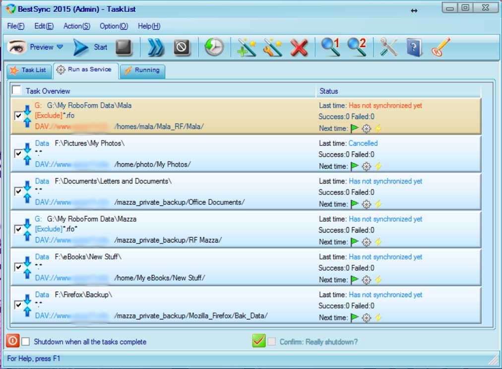

Re: Realtime sync not realtime anymore
I just looked into this a bit further
After startup the jobs in the tab - Run as Service have he status #not syncronized yet.
I have to start every job in this tab manually to allow syncing, pressing the start error does not run all the jobs in this tab sequentially.
Once a job has been started and then synced, it will display the status Monitoring file change.
Hope this helps
Hope this helps

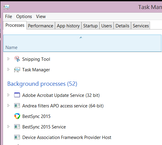

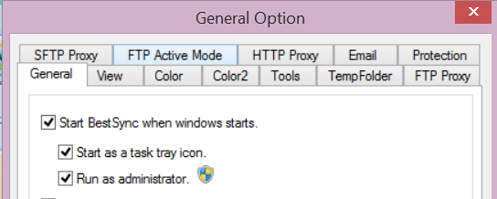

- bestsync-25-01-15.jpg (87.92 KiB) Viewed 25767 times
- bestsync3 25-01-2015.PNG (39.37 KiB) Viewed 25767 times
Please confirm if "BestSync Service" is started in the service manager of the administrator tools of Control Panel.
If the service is not started, please start the serivce. If you can not find the service, please download the newest installer, then install Bestsync again.
I believe the service has started with windows.
Thank you for taking the time to try and solve this.
- bestsync1 26-01-2015.PNG (21.79 KiB) Viewed 25765 times
