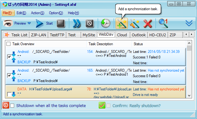

In BestSync main window, click "Add a synchronization task" button to add a task.

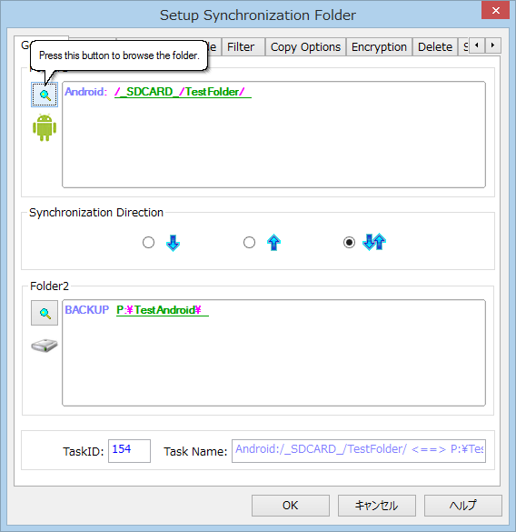

In the task wizard, setup the sychronization folders.
  1. Click the browsing button of Folder1 to select the folder in in Android device. See the steps of next paragraph.
  2. Click the browsing button of Folder2 to select the folder in in Windows' local drive, or any other folder such as NAS folder, Cloud Storage folder that BestSync supports.
  3. Click the "Next" button.

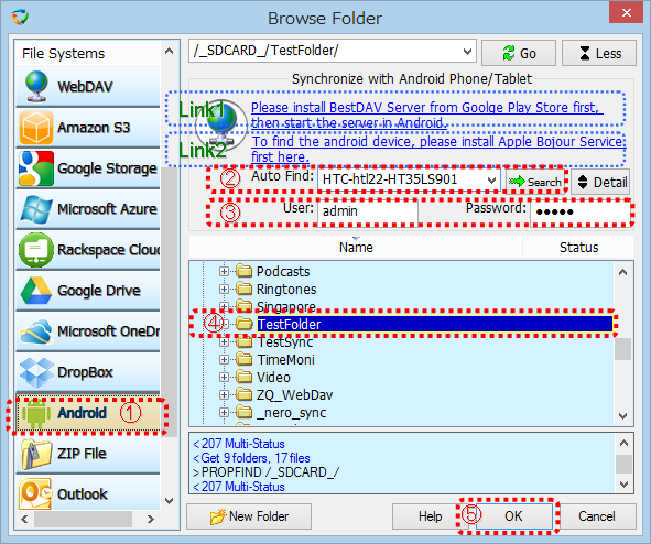

  1. Select "Android" in the list of File Systems.
  2. (1) If the Android device has not installed BestDAV WebDAV Server, click the "Link1" in the right screenshot, to install BestDAV from Google Play to the Andoid device. After installed BestDAV, start the server.
    (2)For detecting the IP address of the Android device, please install Apple Bonjour Service by clicking "Link2" in the right screenshot. If Bonjour is installed, BestSync can find the IP address of the Android device even if the IP address of the device is changed.
    (3)BestSync usually detects the Android device that has started the BestDAV server automatically. You can also click the "Search" to find the Android device.
    If the Android device is listed in the combo-box, select the device.
  3. Input the account of BestDAV WebDAV server. The default User is admin. The default Password is admin. You modify the account in BestDAV WebDAV Server.
  4. When the folders in Android device is listed in the tree view, select a folder that you want to synchronize with.
    There are some special folders defined by BestDAV.
    "/_SDCARD_/" is the interal memory card. "/_EXT_SD_/" is the first external SD card. "/_EXT_SD2_/" is the second external SD card if have.
    If the folders are not listed in the tree view, you can click "Go" button to update the tree view.
  5. Click OK to end the browsing dialog box.

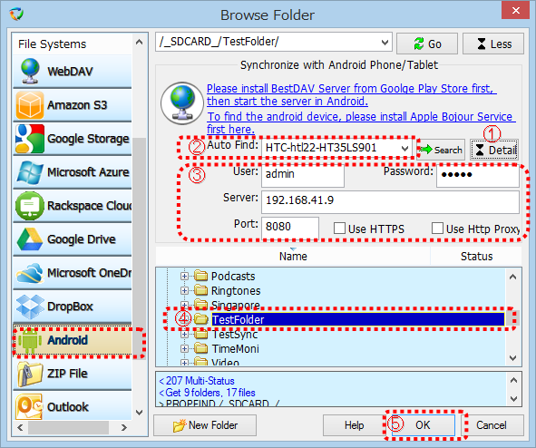

If Apple Bonjour Service has not benn installed, of the auto-detect function can not find the Android device, follow the below steps to setup the WebDAV server manually.
  1. Click "Detail" button to show the detailed settings.
  2. Select "Manual Setting" in the "Auto Find" combo-box.
  3. Input the IP address and port number according to the display url in BestDAV main window. If SSL setting is enabled in BestDAV server, check "Use HTTPS" option.
  4. If the folders are not listed in the tree view, click "Go" button to update the tree view. When the folders in Android device is listed in the tree view, select a folder that you want to synchronize with.
