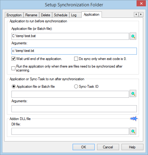

We have tested on BestSync ver8.0.6.3, the result is OK.
Here is the setting of the Application Tab:
[attachment=1]RunBatch.png[/attachment]
Here is the content of the test.bat file:
notepad %1

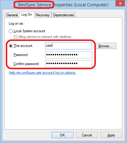

Please note, if the task is running as Windows Service, the environment variables of the current user are not accessible, except you have setup the log on account in BestSync Service (Service Manager of Control Panel) like the following:
[attachment=0]ServiceLogon.png[/attachment]
